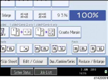

Icon [1]
This icon is lit when there is temporary data to be overwritten, and blinks during overwriting.
Icon [2]
This icon is lit when there is no temporary data to be overwritten.
