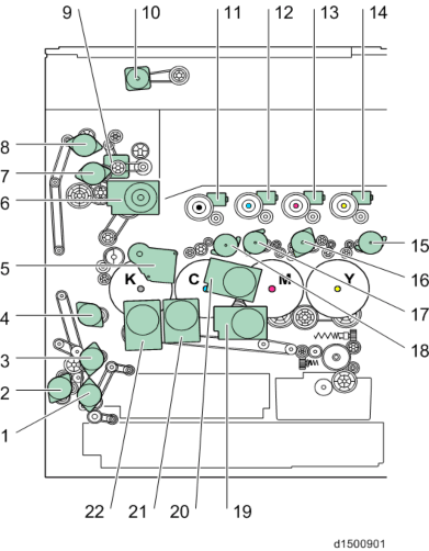

Drive Unit
| No. | Description | No. | Description |
| 1 | Imaging IOB | 7 | Registration Motor |
| 2 | Development Motor: CMY | 8 | PCU Motor: CMY |
| 3 | Development Motor: Black | 9 | Phase sensor |
| 4 | PCU: Black / Image Transfer Motor | 10 | Fusing Motor |
| 5 | Paper Feed Motor | 11 | Paper Exit / Pressure Release Motor |
| 6 | Transport Motor |

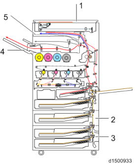

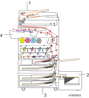

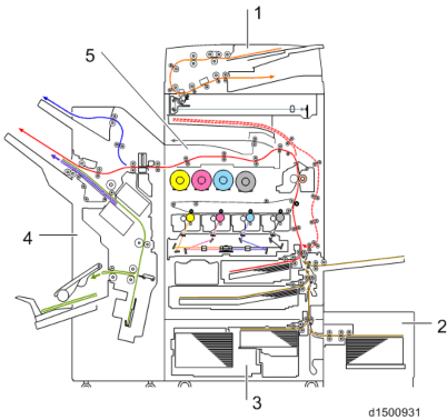

PAPER PATH
No. Description No. Description 1 SPDF DF3080 4 Booklet Finisher SR3150 2 LCIT RT3030 5 Bridge Unit BU3070 3 LCIT PB3170
Product InformationNo. Description No. Description 1 ARDF DF3090 3 Paper Feed Unit PB3160 2 LCIT RT3030 4 Internal Finisher SR3130

No. Description No. Description 1 Paper feed motor 12 Toner bottle drive motor (C) 2 Duplex / By-pass motor 13 Toner bottle drive motor (M) 3 Transport motor 14 Toner bottle drive motor (Y) 4 Registration motor 15 Toner transport motor (Y) 5 Paper transfer contact motor 16 Toner transport motor (M) 6 Fusing motor 17 Toner transport motor (C) 7 Paper exit / Pressure release motor 18 Toner transport motor (Bk) 8 Duplex entrance motor 19 Development Motor: CMY 9 Inversion motor 20 PCU Motor: CMY Product InformationNo. Description No. Description 10 Scanner motor 21 Development Motor: Black 11 Toner bottle drive motor (Bk) 22 PCU: Black / Image Transfer Motor
