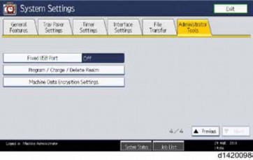

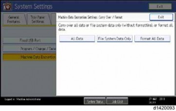

  4. Press [Machine Data Encryption Settings].If this item is not visible, press [Next] to display more settings.
  5. Press [Encrypt].
Installation
  1. Select the data to be carried over to the hard disk and not be reset. To carry all of the data over to the hard disk, select [All Data].
    To carry over only the machine settings data, select [File System Data Only]. To reset all of the data, select [Format All Data].

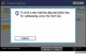

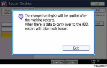

  2. The following message will be displayed. Press the [Start] key to print the encryption key for safe keeping.
  3. Press [Exit] to remove the following message.
  4. Press [Exit] again.

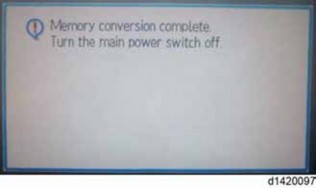

    • After step 10, the initial operation display appears as below. However, HDD data encryption has not been completed at this moment. Step 11 and step 12 should be performed in order to encrypt the HDD data.
  6. Turn the main power switch off and on.
  7. "Memory Conversion complete. Turn the main power switch off" is displayed as below. Then turn the main power switch off and on.
  8. Then initial operation display appears again. After this step, HDD data encryption has already been completed.

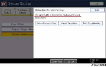

  5. Please confirm whether the encryption has been completed or not on this display.

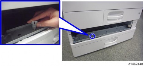

      2. Make sure there is no paper left in the paper trays. Then fix down the bottom plates with a sheet of paper and tape.
      3. Take out the scanner stay from inside the front door and install the scanner stay.

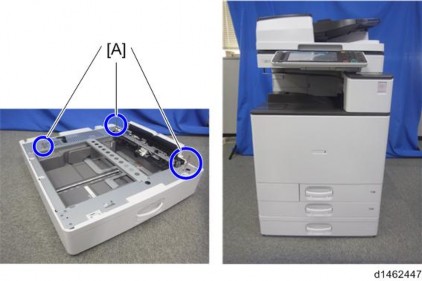

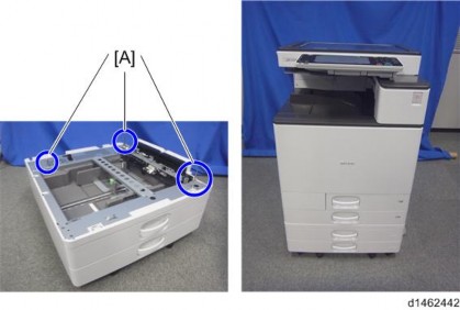

            Holding the grips on the machine, align it with the locating pin [A], and place the machine on the paper feed unit.​

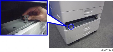

          4. Using securing bracket as a screwdriver, fix the machine to the feed unit (spring washer: screw: M4×10: 1).
          5. Attach the securing brackets [A] to two positions on the left and right at the rear of the machine (screws: 1 each).

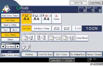

            [*]Set the paper, and check that the paper size set in the paper feed tray is displayed on the operation panel.

          3. Holding the grips on the machine, align it with the locating pin [A], and place the machine on the paper feed unit.

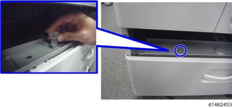

          5. Using a securing bracket as a screwdriver, fix the machine to the feed unit (spring washer: screw: M4×10: 1).
          6. Attach the securing brackets [A] to two positions on the left and right at the rear of the machine (screws: 1 each).
