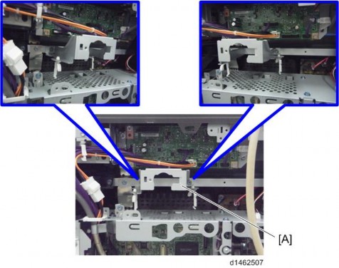

Bracket [A] ( ×2)
4.
5. Attach the 2 clamps to the bracket provided.
Attach the bracket [A] to the frame ( ×2)
