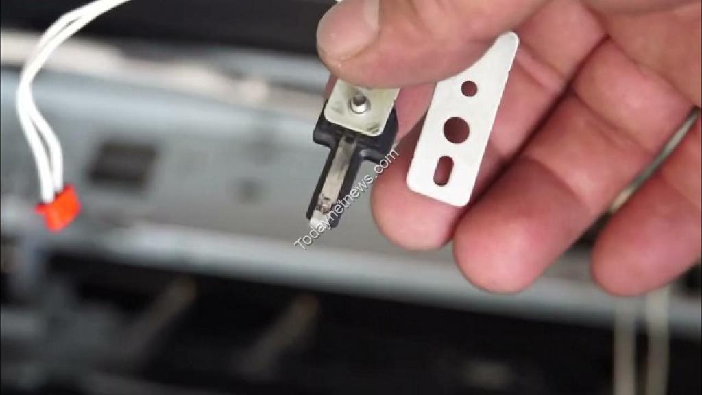

The resistor is dusty or dirty
Thermistor is dead or weak

If the error is still not cleared, continue to perform the following operations: Remove the dryer assembly and measure the circuits, check if the fuse is broken or not, check if the sensor is damaged or not. If so, you should replace those parts, after replacing, remember to perform the error clearing operation above again so that the machine can operate normally again.

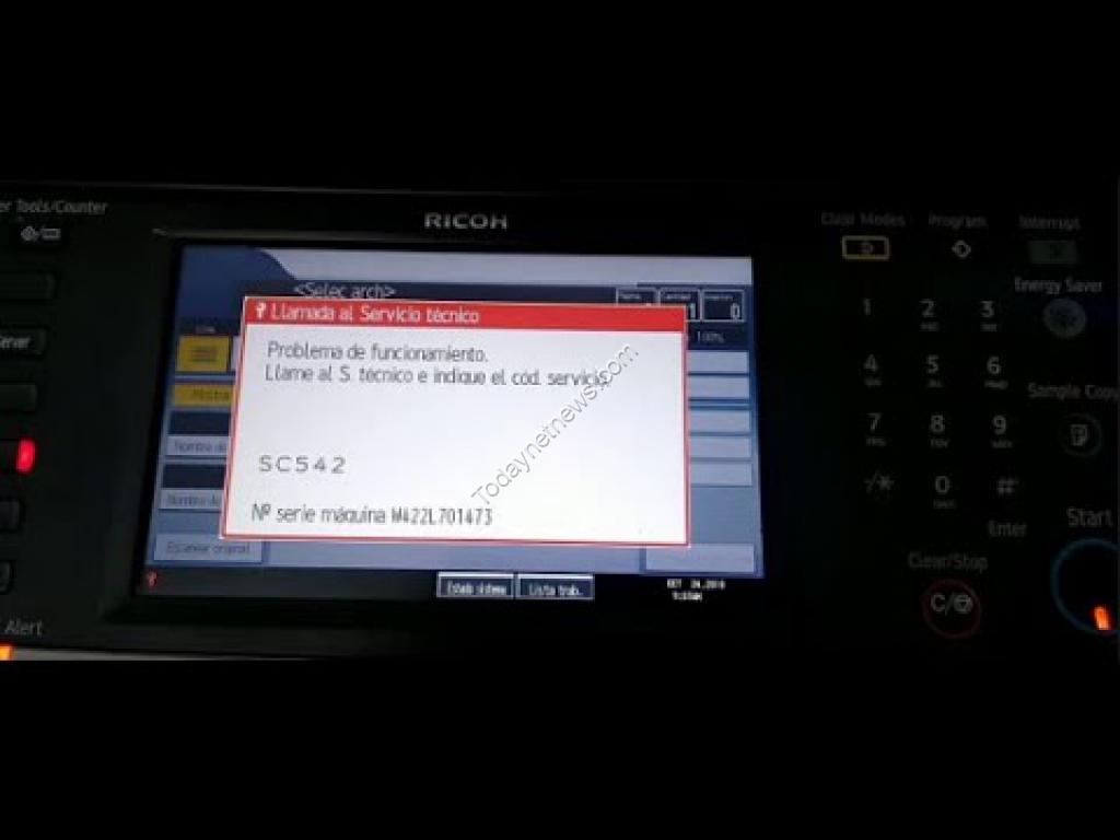

SC 542 Error on Ricoh Machine
When encountering error 542 on Ricoh machine, it may be due to the cause of damage due to the drying part having problems while waiting for drying:
Thermistor is faulty

If the screen displays error 542 on Ricoh machine, you need to perform some error clearing operations for the machine. If after clearing the error is not successful, you need to fix the error as follows:
Check the Thermistor, check the bearing, Drying Roller bearing and replace it if the part is damaged
Check if the drying part, drying bulb is faulty or not, if so, replace the new Sensor
