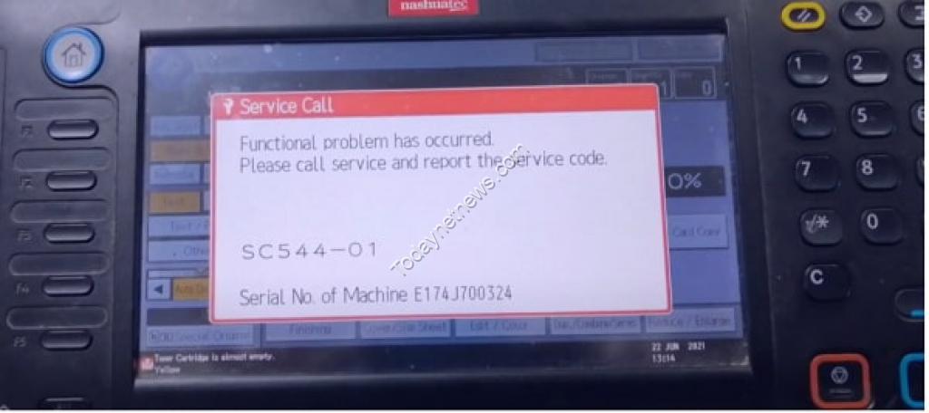

What is the SC 544 error on Ricoh machines and what is the cause of the error?
Causes of SC544 error on Ricoh photocopiers
Ricoh reports SC 544 error from the main cause of the fuser system when the fuser unit heats the ink and overheats, at this time the BCU will detect and identify the error.

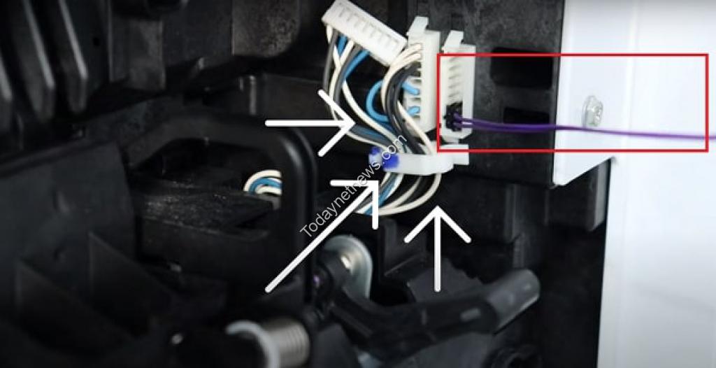

Step 1: Remove the fuser unit to check if the silk cover is torn or not. If everything is normal, you do the next step.
Step 2: Prepare an unused thermistor to cut off a thermal probe and keep the jack. Then find a double wire or power cord. Note: one end will be connected to the thermistor jack, the other end is connected to the switch.
Step 3: Turn on the photocopier, remove the dryer to connect to the dryer and close the photocopier cover so that the reset wire is exposed to the outside, then enter the code to restore the machine
Step 4: Press the yellow Reset button + enter the code "80682" + press the Clear button (C) and hold for 10 seconds until the System SP box appears
Step 5: Find item 5810-2 (item: "Hard high Temp. Detection). Then select "Execute", then open the wire connector and the machine will notify "Complete". That means you have successfully reset.
