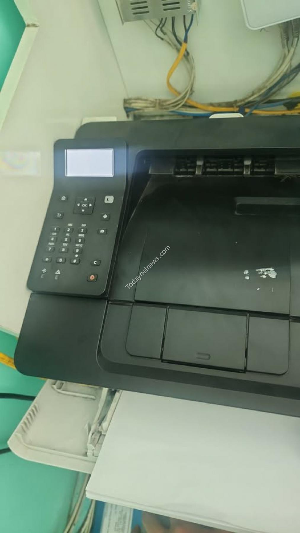

I have a Canon LBP 212dw printer that turns on a white screen, the screen doesn't display anything. When I connect the printer to the computer, it doesn't recognize it. Can you guys tell me why the Canon LBP212dw has an error that the screen won't display. Can't print? How to fix it?
Canon i-SENSYS LBP212dw printer has a white screen error and cannot print.jpg

If the printer does not recognize the formatter card, you need to try replacing the formatter first
Evelyn
Currently, your printer has 2 errors
1: Printer screen error does not display
2: Computer error does not recognize the printer
With these 2 errors, first the printer does not recognize the printer, you should try replacing the formatter card first to see if both errors are gone because the error of the screen not displaying is related to the formatter card.
If the error does not go away, you need to try replacing the printer screen.
O
Oralie
The screen is pure white, is it still receiving the port? If it doesn't receive the port, the formatter controller is broken
