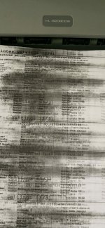

Brother HL-B2080dw printer black print
Probably poured the wrong ink
Replace the drum and wiper
Buy a new ink cartridge.

replied to the thread
Clean the ink, pour another ink
Clean the old ink, clean the charging shaft, magnetic shaft, pour the right type of ink and it's ok
Replacing the cartridge is quick.
Use a magnet to see if the ink sticks

Lealia
Do you refill the ink yourself?

Imelda
error drum unit/incorrect ink
Wrong ink, replace with another ink and it's gone.
in
Brother
I have a brother HL-B2080dw printer that prints black like this. What's wrong? Please give me some advice. Thanks.
