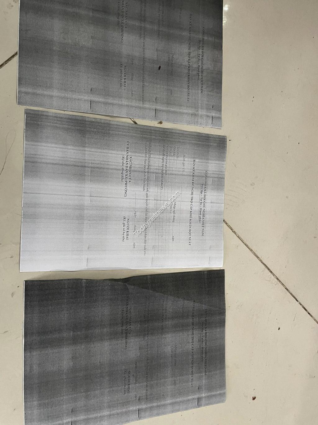

I have a Sharp AR-M460N photocopier with black printout as shown in the photo. After cleaning the drum unit, it was white, but after a few pages, it turned black again. One day it was completely black, the next day it was a little white again. I took 3 photos and printed them on 3 different days. I suspect it's high voltage, but this item is expensive and you can't return it. I'd like to ask you guys to diagnose the problem for me. Thank you.

If cleaning the high pressure doesn't fix this error, replace the components, replace the drum unit...
This error is usually due to high pressure, power source.

Remove the drum unit to clean it, clean the high voltage drum, the high voltage next to the black charging shaft...

So you have to contact the big guys who specialize in Sharp products to borrow to test, because this product is rare and the price is a bit high because few people use it
