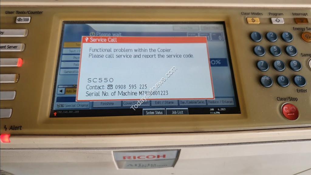

<blockquote data-quote="John" data-source="post: 449" data-attributes="member: 2"><p><strong>Causes of SC 550 error on Ricoh machines</strong></p><p></p><p>Ricoh Aficio MP machines or other industrial machines such as 1060, 6000, 6500, 8001, 9001, 2075 will report error SC 550 when the dryer runs out of oil wiping paper. After a period of use, the sensor will receive 5 times of running out of paper in 500ms. The paper wiping motor will rotate continuously for 40 seconds. At this time, the sensor continues to detect that the dryer roller paper is out for another 400 seconds, then it will report error SC 550 on Ricoh machines.</p><p></p><p>[ATTACH=full]57[/ATTACH]</p><p></p><p><strong>How to fix error SC 550 on Ricoh photocopiers</strong></p><p>When you encounter a situation where the Ricoh machine runs out of paper to wipe the dryer roller, you need to replace the new oil wiping paper roll. If you see the machine displaying error SC 550, you need to perform the following steps to fix the error:</p><p></p><p>Step 1: Re-install the oil wiping paper roll on the dryer</p><p></p><p>Step 2: Press the yellow “Clear mode” key on the keyboard → continue pressing the number sequence “1 0 7” and hold the red “Stop clear” key until the screen displays the SP Mode table. Continue pressing the SP copy item on the copier screen.</p><p></p><p>Step 3: Press the number sequence “1 9 0 2 #” on the keyboard, when you see the machine displaying the value, set the machine to “0” and turn off the machine within 10 seconds. Then restart the machine to clear the SC 550 error on the Ricoh machine.</p><p></p><p><strong>Note when fixing the SC 550 error on the Ricoh copier</strong></p><p>If it is not due to running out of oil wiping paper, it may be due to other causes such as running out of oil, incorrect rotation parameters of the oil paper.</p><p></p><p>Wrinkled paper rolls are also the cause of error 550 Ricoh machines. You should check the paper rolls again to find the correct solution.</p><p>The quality of the ink is not guaranteed or the ink is leaking. At this time, you need to replace the ink with quality and compatible with your machine model.</p></blockquote><p></p>
[QUOTE="John, post: 449, member: 2"] [B]Causes of SC 550 error on Ricoh machines[/B] Ricoh Aficio MP machines or other industrial machines such as 1060, 6000, 6500, 8001, 9001, 2075 will report error SC 550 when the dryer runs out of oil wiping paper. After a period of use, the sensor will receive 5 times of running out of paper in 500ms. The paper wiping motor will rotate continuously for 40 seconds. At this time, the sensor continues to detect that the dryer roller paper is out for another 400 seconds, then it will report error SC 550 on Ricoh machines. [ATTACH type="full"]57[/ATTACH] [B]How to fix error SC 550 on Ricoh photocopiers[/B] When you encounter a situation where the Ricoh machine runs out of paper to wipe the dryer roller, you need to replace the new oil wiping paper roll. If you see the machine displaying error SC 550, you need to perform the following steps to fix the error: Step 1: Re-install the oil wiping paper roll on the dryer Step 2: Press the yellow “Clear mode” key on the keyboard → continue pressing the number sequence “1 0 7” and hold the red “Stop clear” key until the screen displays the SP Mode table. Continue pressing the SP copy item on the copier screen. Step 3: Press the number sequence “1 9 0 2 #” on the keyboard, when you see the machine displaying the value, set the machine to “0” and turn off the machine within 10 seconds. Then restart the machine to clear the SC 550 error on the Ricoh machine. [B]Note when fixing the SC 550 error on the Ricoh copier[/B] If it is not due to running out of oil wiping paper, it may be due to other causes such as running out of oil, incorrect rotation parameters of the oil paper. Wrinkled paper rolls are also the cause of error 550 Ricoh machines. You should check the paper rolls again to find the correct solution. The quality of the ink is not guaranteed or the ink is leaking. At this time, you need to replace the ink with quality and compatible with your machine model. [/QUOTE]
